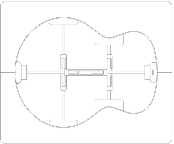

I agree with Hesh. I use a turnbuckel system like this

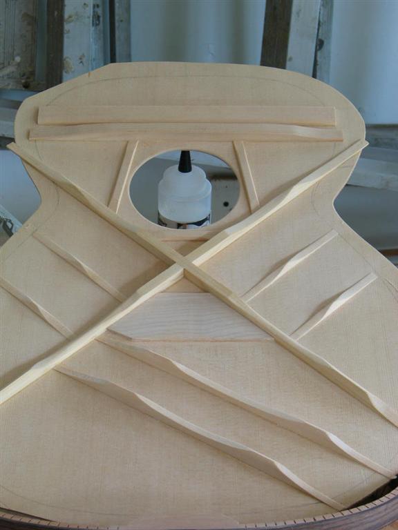

Im doing a luthier mercintile kit bolt on neck.The sides were prebent but did
not fit my mold quiet right.So I bent the sides at the waist a bit and that
helped alot,Yes keeping the front and rear blocks are important.Hers some
pics.Thank you all. 2006-07-07_141141_guitar3.jpg">
PostPosted: Fri Jul 07, 2006 5:48 am
Posts: 8553
Posted for Bill LanceK38905.6260763889

PostPosted: Fri Jul 07, 2006 3:11 pm
Bill, your bracing is very neat!
PostPosted: Fri Jul 07, 2006 4:49 pm
Posts: 298
Bill your bracing is very neat and clean. You could never get a job at Gibson. I have seen some of their old top brace jobs. Lots of squeeze out and smears on the top's. I guess they figured if you cant see it it doesn't hurt. Keep up the good work.Michael Shaw38906.0764236111

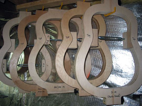

Here's what I do.
I saw something like it somewhere and it stuck in my memory. I think it was a Huss and Dalton thing. It seems to work pretty good!
Brent
PostPosted: Sat Jul 08, 2006 10:20 am
Brent, i really like this kind of set up! Thanks!
PostPosted: Sat Jul 08, 2006 1:25 pm
Hey Brent,
It looks like you're doing something I contemplated for a while:
Is that mold mounted to a stand, so that the whole thing can be flipped over, top to back to top again?
It's a cool idea, and if that's what you're doing, some more pix would be great.

Steve -Yes I mount my molds on this stand. I designed it so I could glue linings on one side then filp and glue the other without waiting
I have six different molds so I made it ajustable
This is how I mount them
I also found it useful for gluing tops and backs.
I also learned I can "drive the bus" on it!!
Art - I get my molds from Home Depot
Brent
